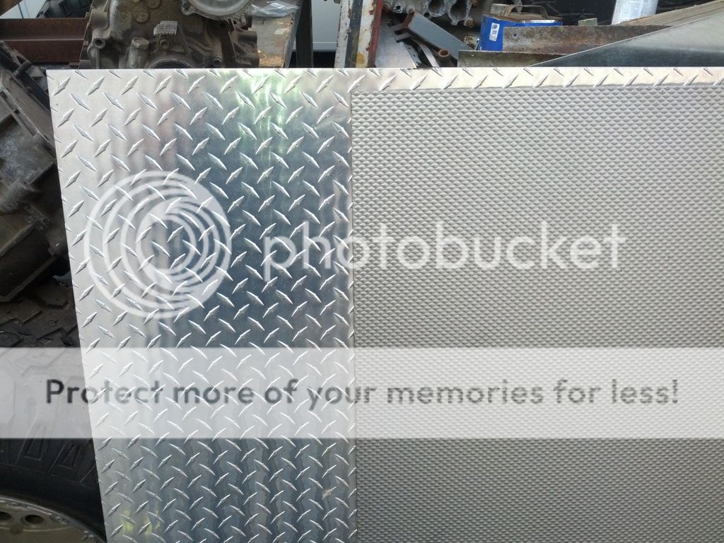

Here it is next to my diamond plate stuff.
Posted Image
So the idea I came up with is since the diamond plate is a thick 1/8inch aluminum sheet and is strong but light, I can use that stuff inside. I wanted to mix up the two metals and give this unique trailer a look no one will dare copy.

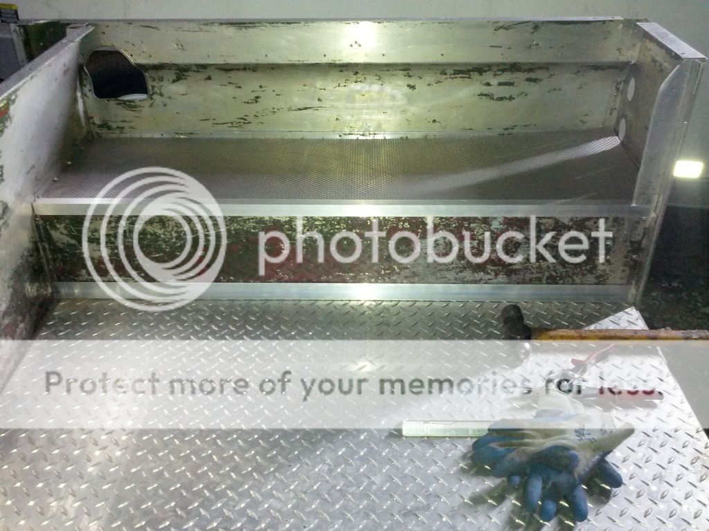

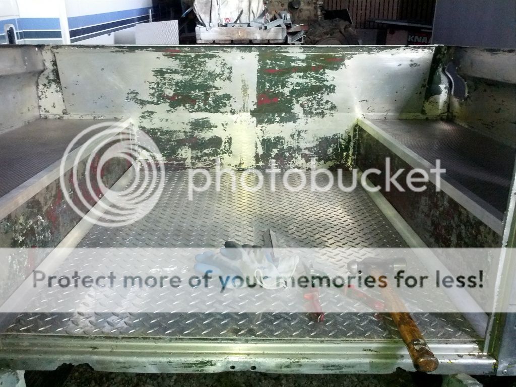

The inside came out great. I'm more excited now. Time to focus on the rotted corners below. I have to flip this thing over and decide what to do from here. I need to cut.... Well I mean trim.
Posted Image
Posted Image
Posted Image
Posted Image
I trimmed what needs to be removed and got filling in covers for the quarter panels. Using masking tape to draw lines for the corner caps and get a visual on what it would look like and what fits right for this body.
