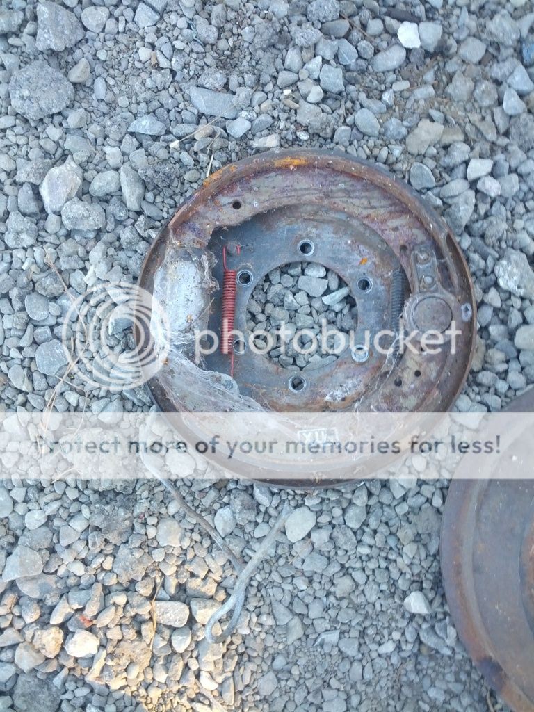

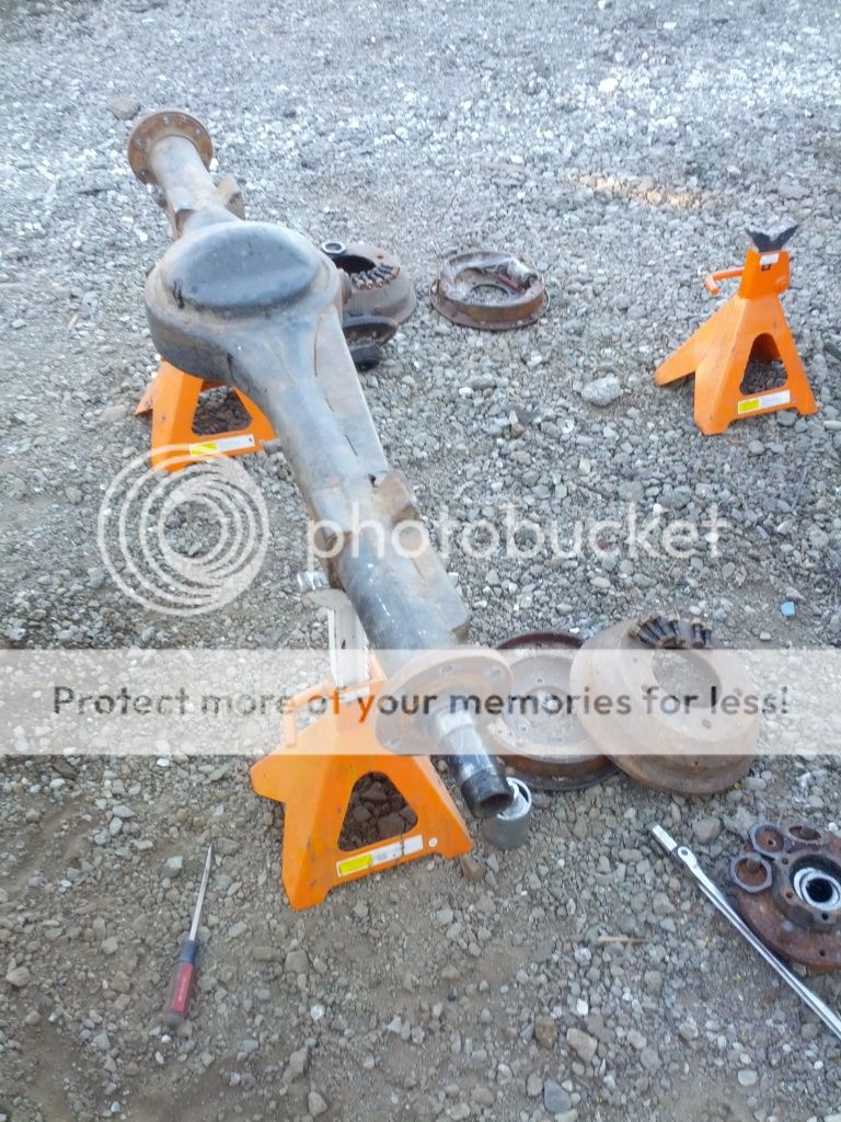

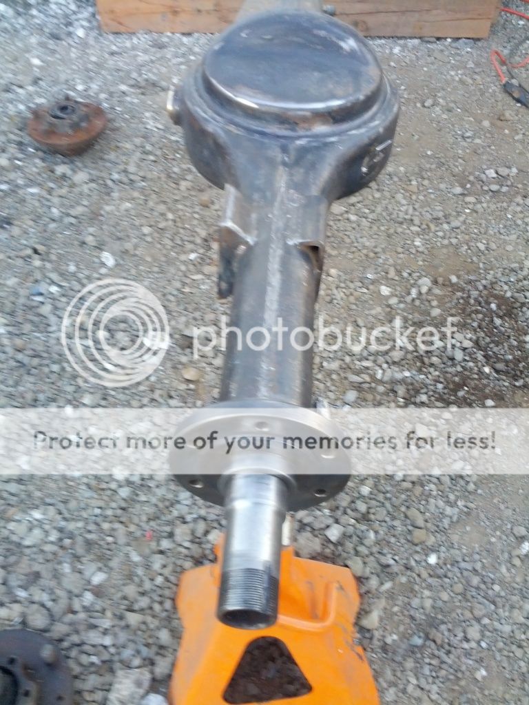

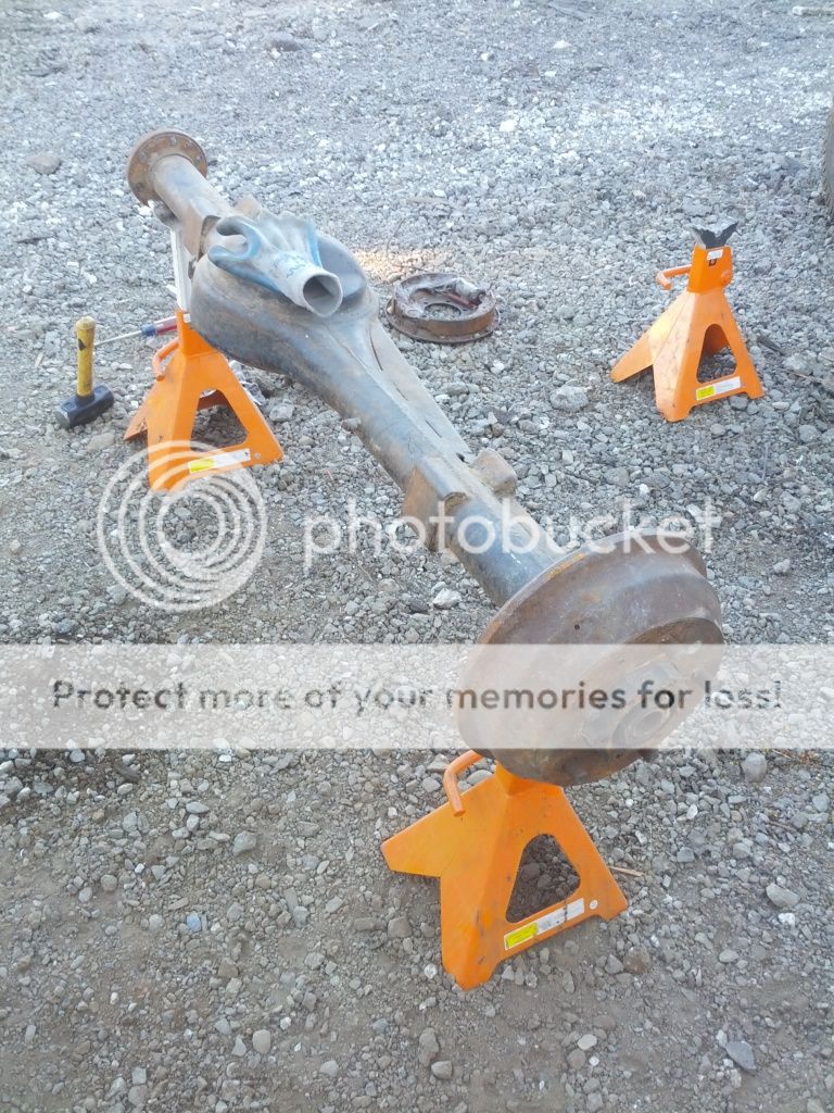

So here is a list of things I have removed. Well a picture of it.
Posted Image
Posted Image
Do it to both sides and your that much closer to ..... well your closer.

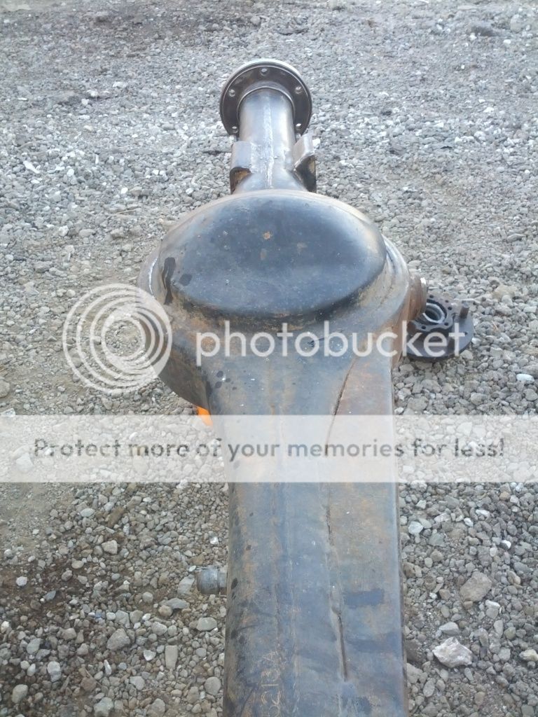

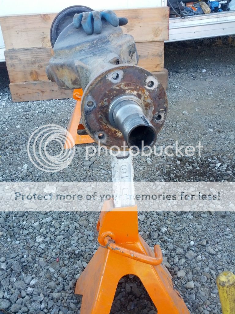

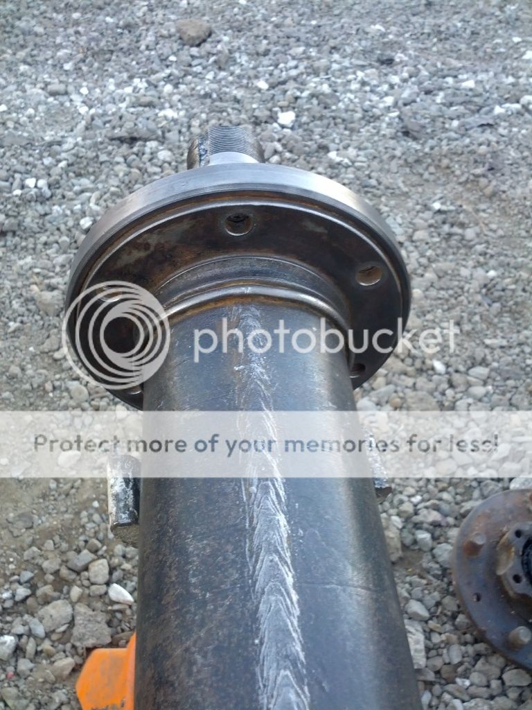

Here is your naked axle. But this one is mine.
Posted Image
Posted Image
Posted Image
Posted Image

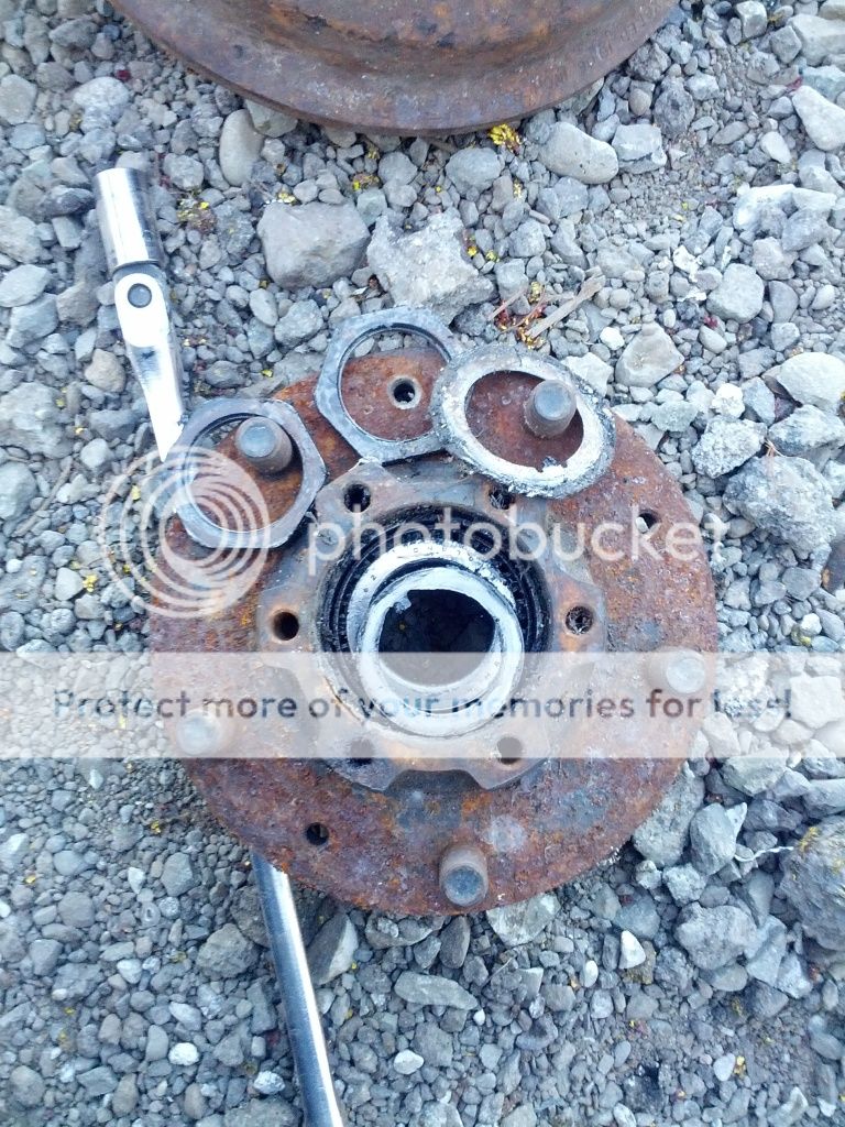

So here is my favorite tool again. You might want this on your Xmas list. Very handy.
Posted Image
