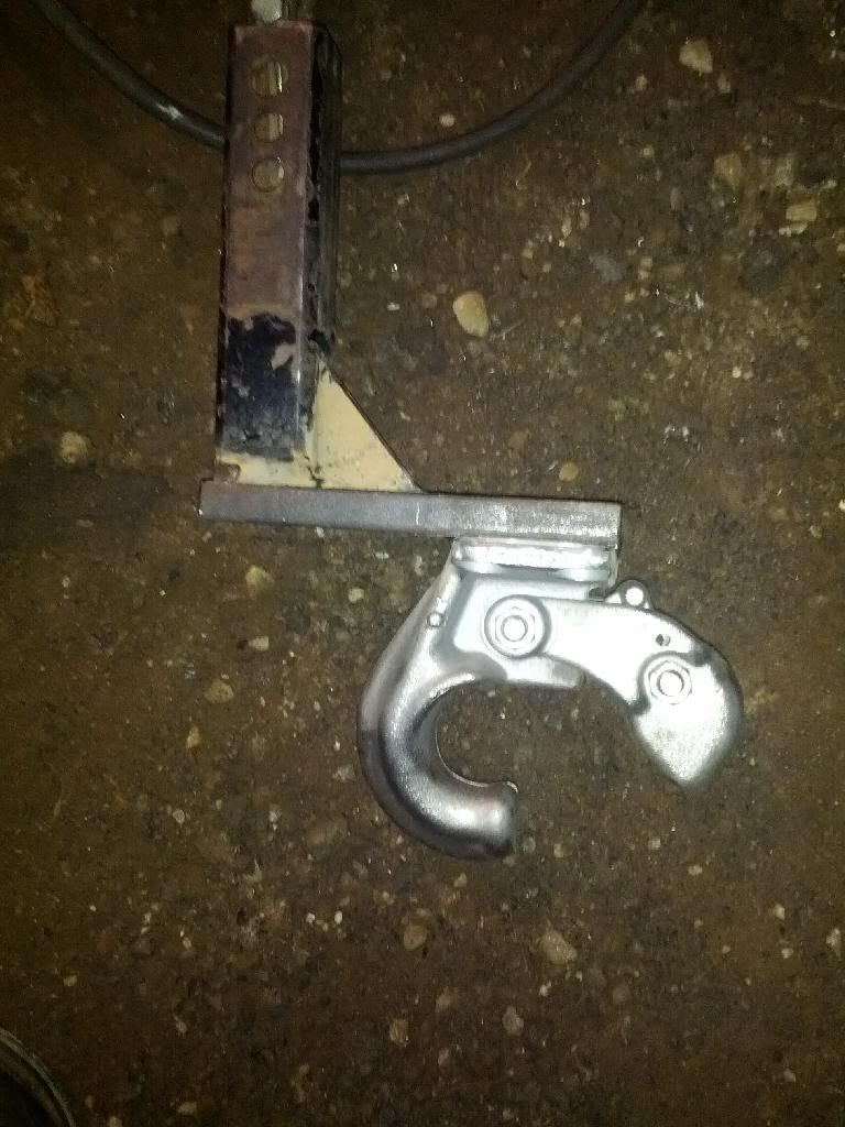

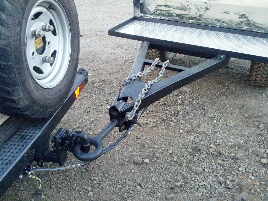

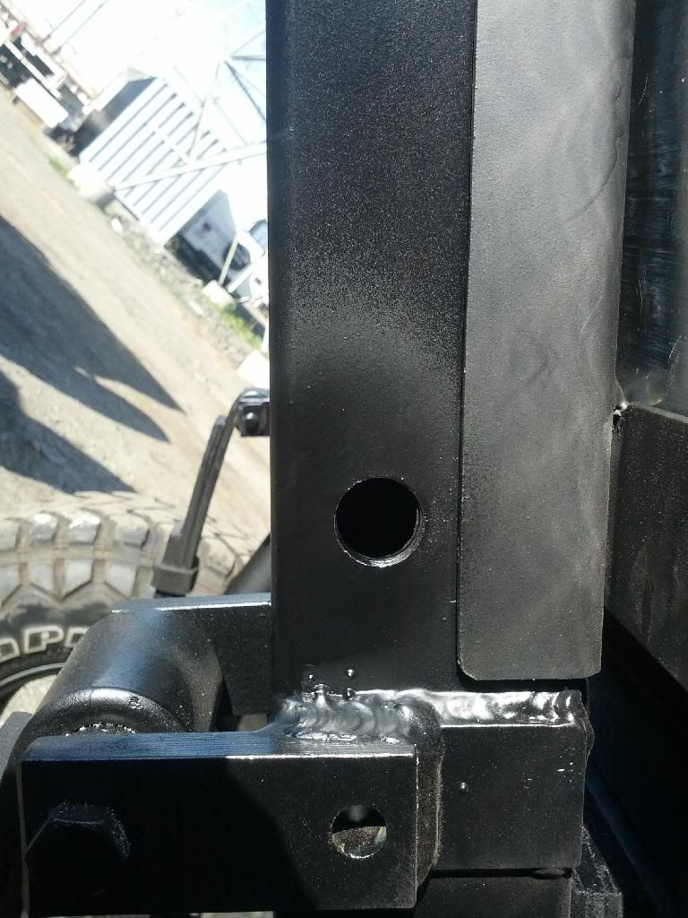

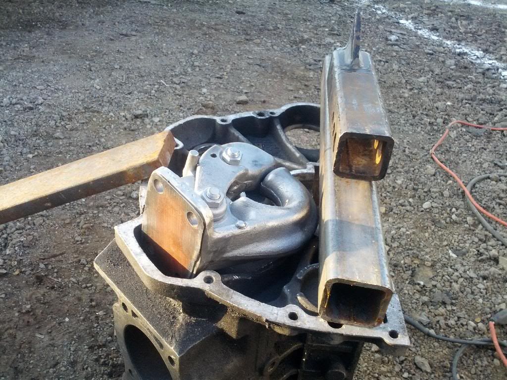

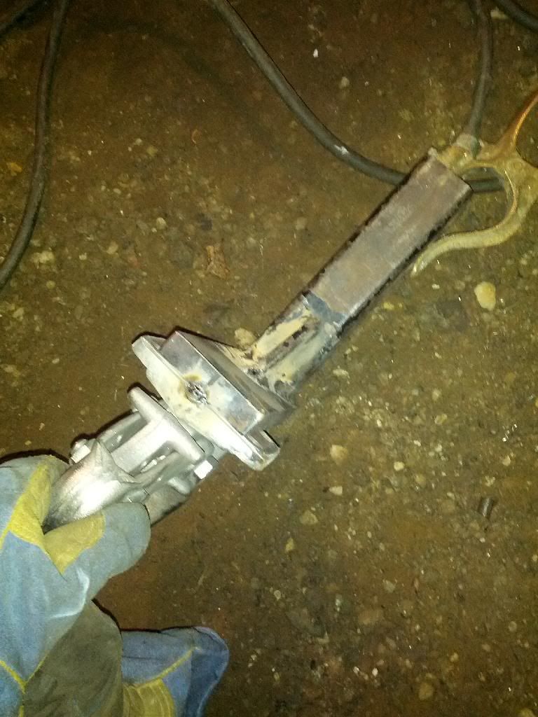

First day of the year and I'm at it again.

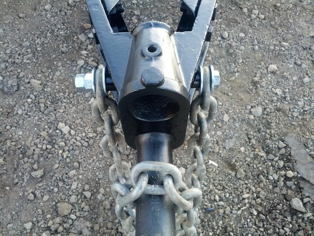

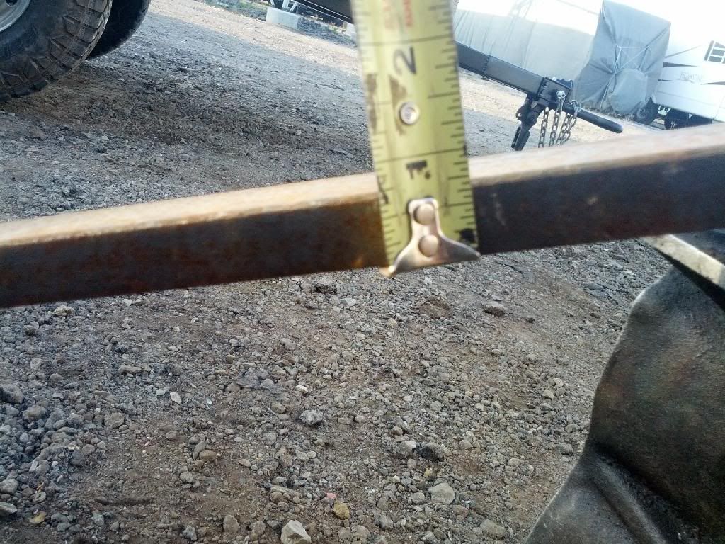

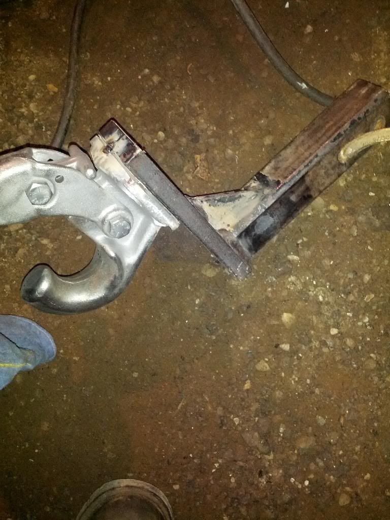

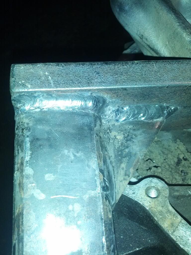

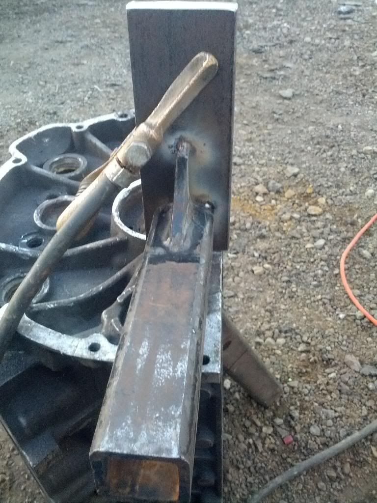

I wanted to get the pintle for the car side ready and get it out of the way. I'm that close for towing around. Found some 3/4" plate laying around and found a use for it. That's some serious metal. I had a 3-4 foot bar and tried to bend it with my weight and I didn't even see it flex. That tells me that this is over kill. Perfect for my application.

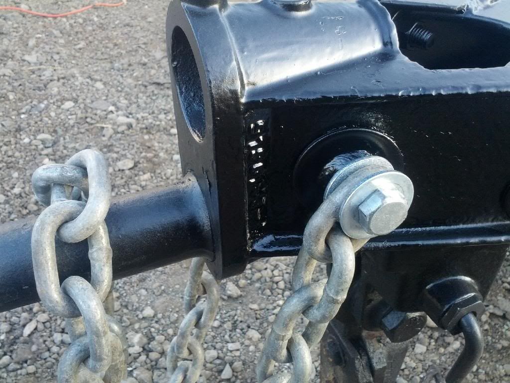

Then it was time to instal the safety chains.
Posted Image
Posted Image

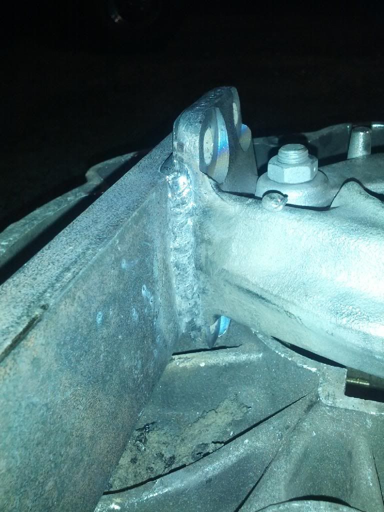

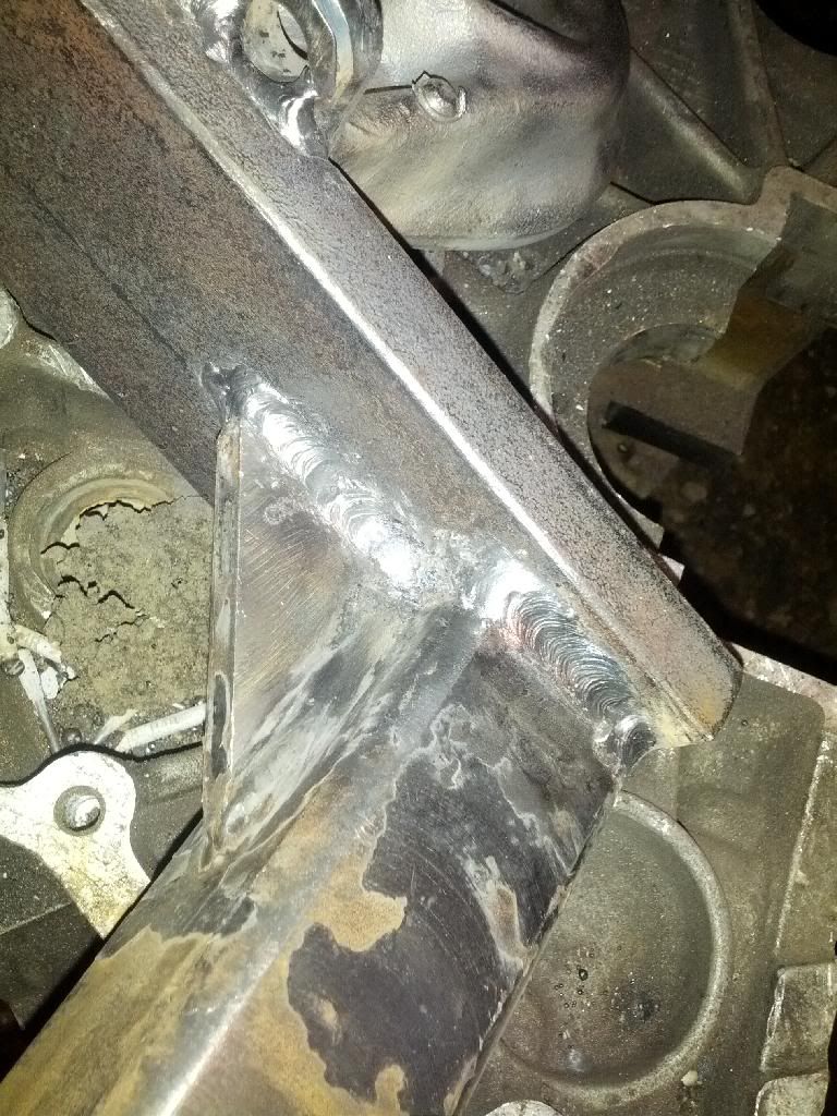

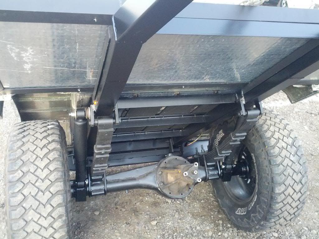

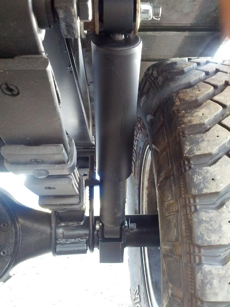

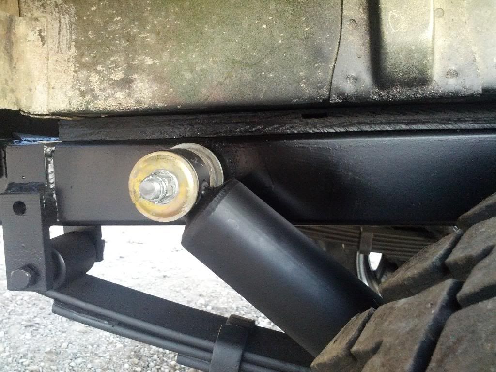

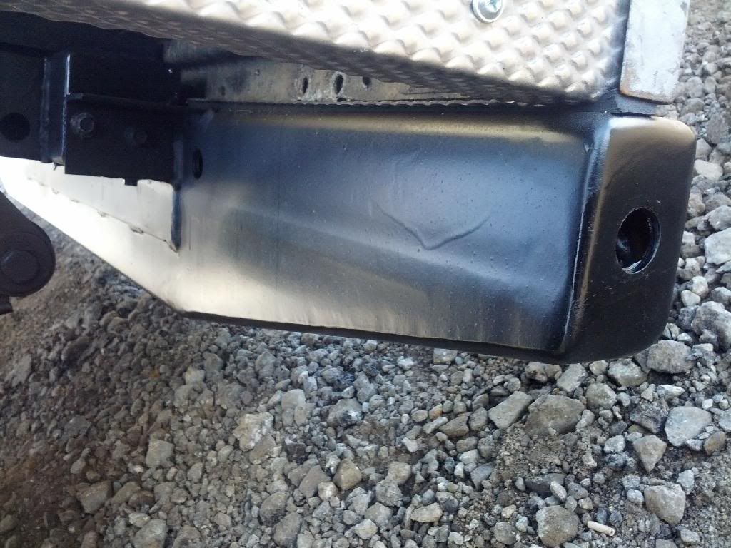

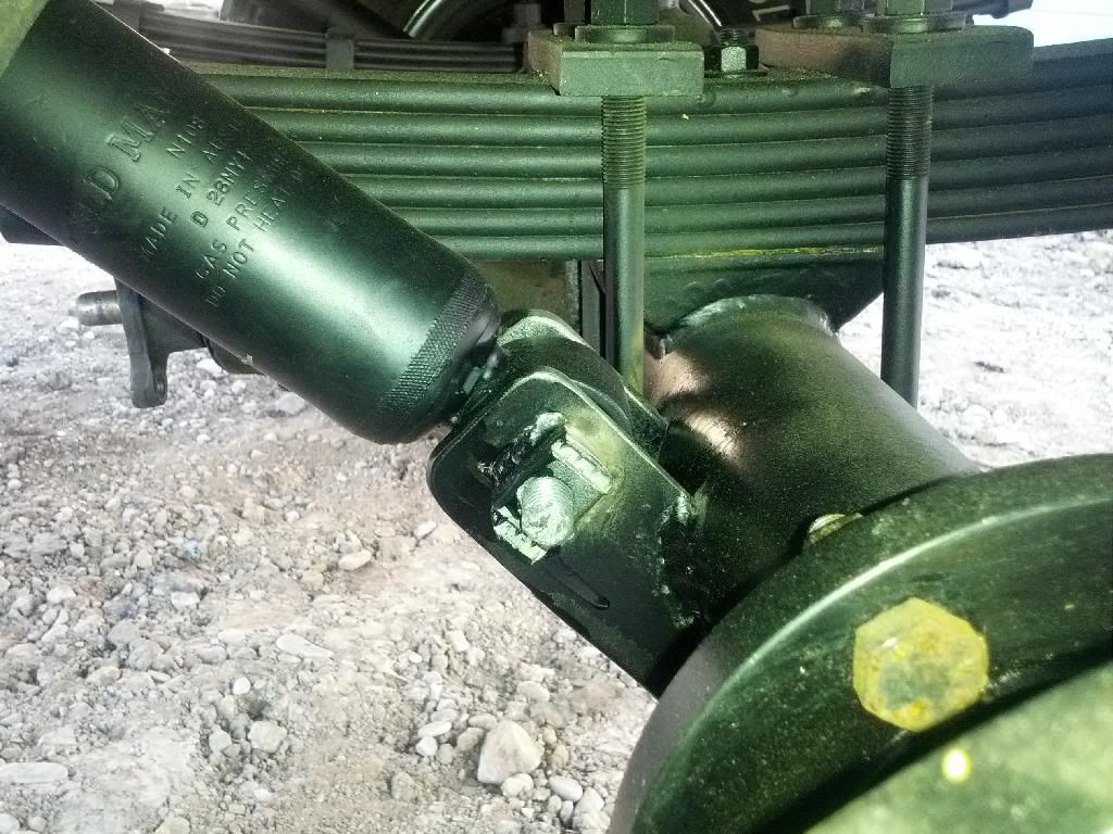

After installing those I wanted to take another look and the shock mounts to see what they look like in the day time.
Posted Image
Posted Image
Posted Image
Posted Image

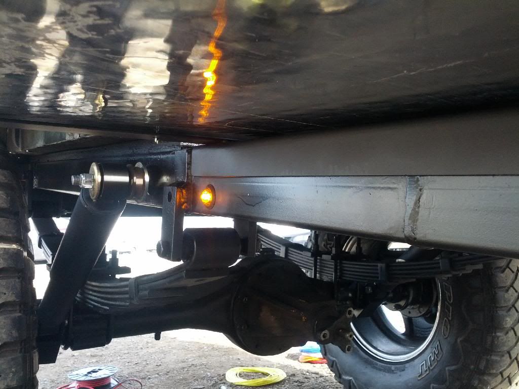

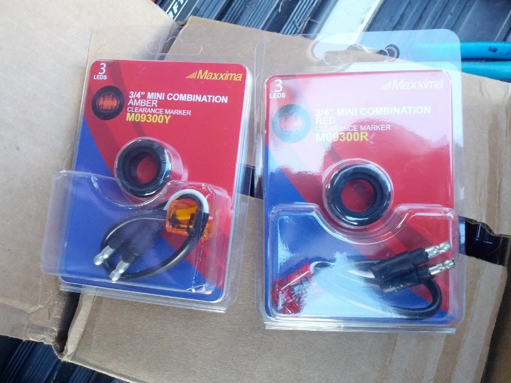

After all this welding and mounting metal brackets I'm ready for some lights. I called my buddy who works for Petterson and asked him to order me some lights. I have the perfect picture in my head for these.
Lucky me he has those exact lights in stock.... Yes they are LED.
Posted Image
Posted Image
Posted Image

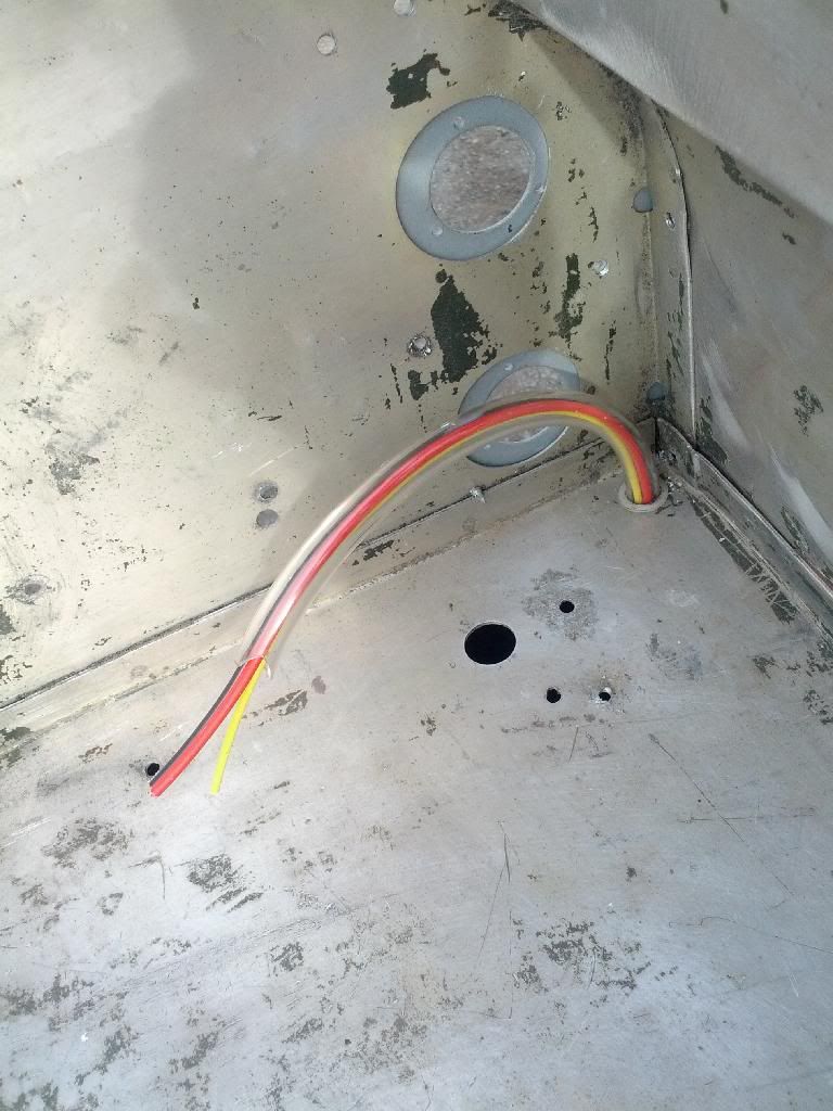

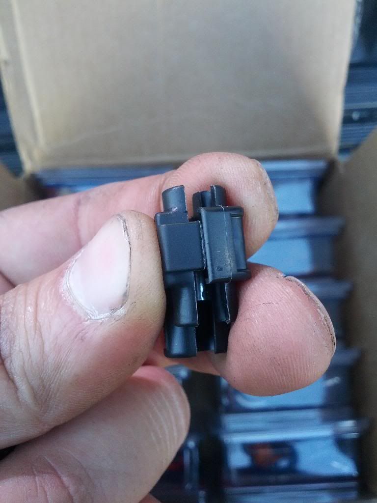

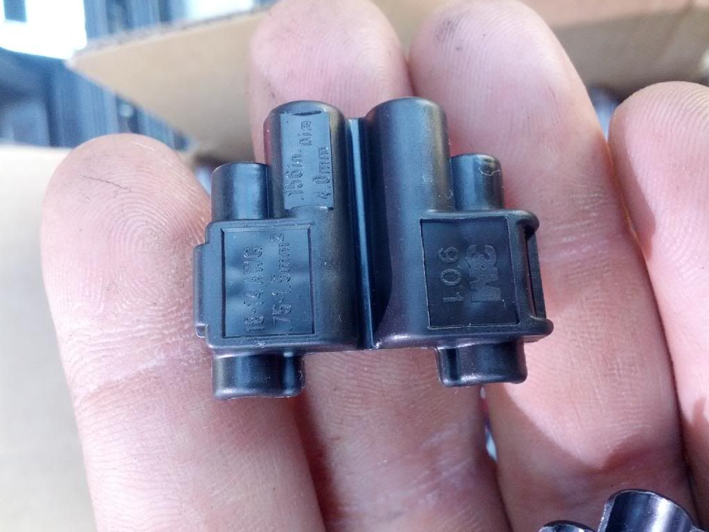

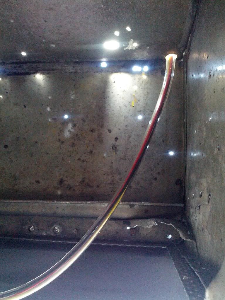

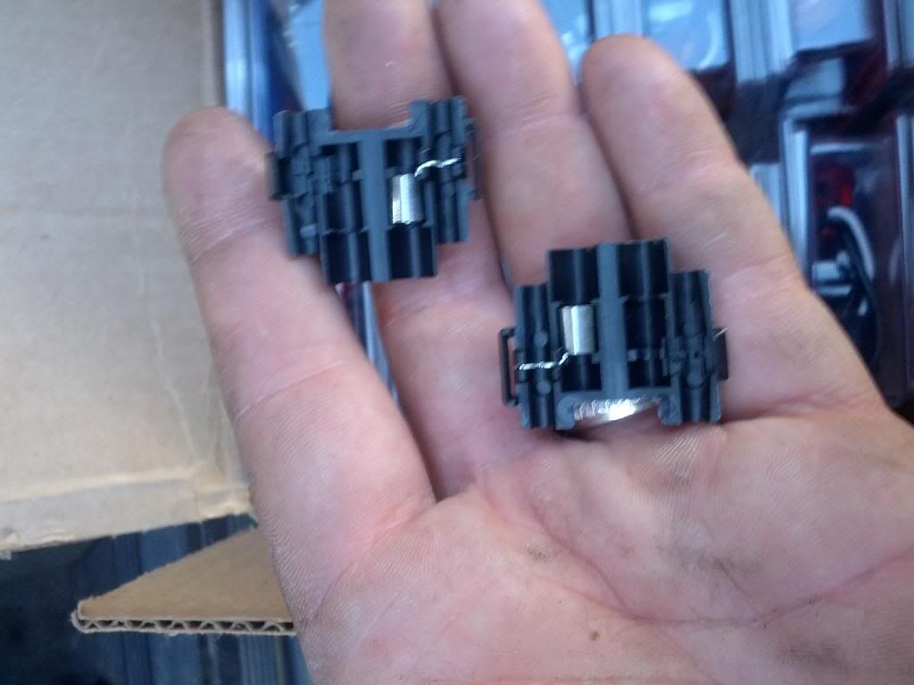

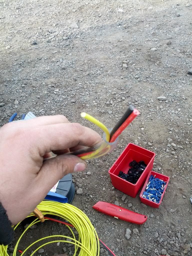

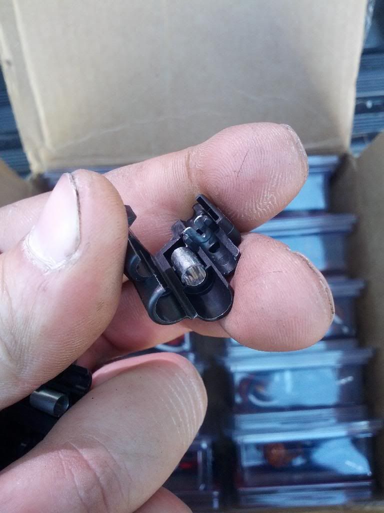

After drilling some holes in the frame and snaking wires through it (such a great way to hind and protect wires) I grab my new favorite connectors from 3M. They save so much time and wiring labor. Easy disconnects and simple to use.

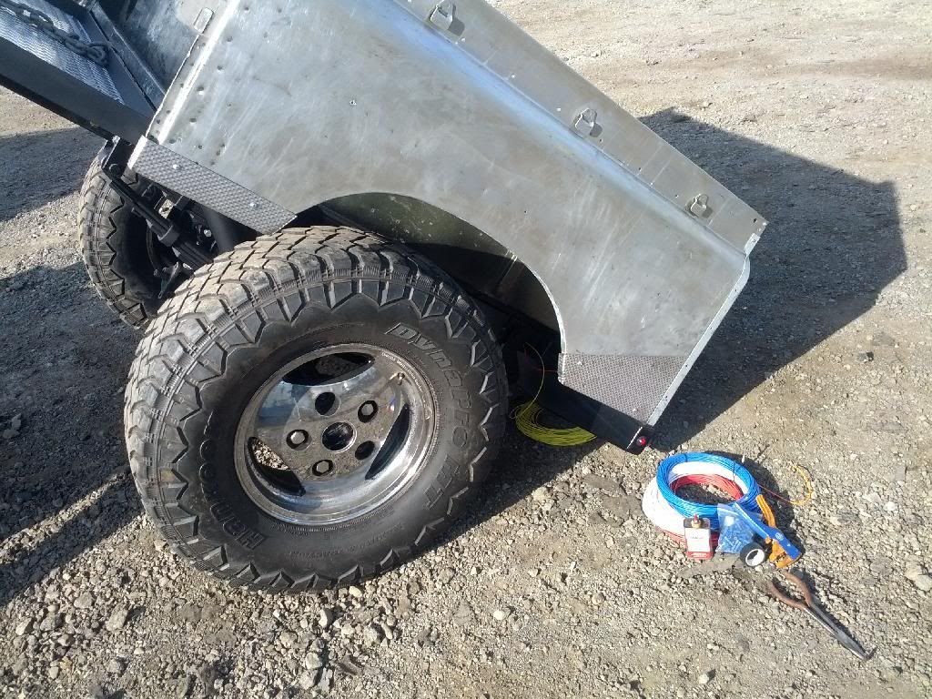

That was just a few of 6 I did so far. I might have more since they are so compact and simple. All these lights come from the factory with grommets and butt connectors called "pigtails". White wires on trailer lighting is always ground and the black in this case is the hot wire. So since my wires are black and red I wired it with red being hot and black is ground. As long as all your wires are the same it doesn't matter.

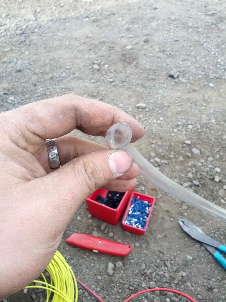

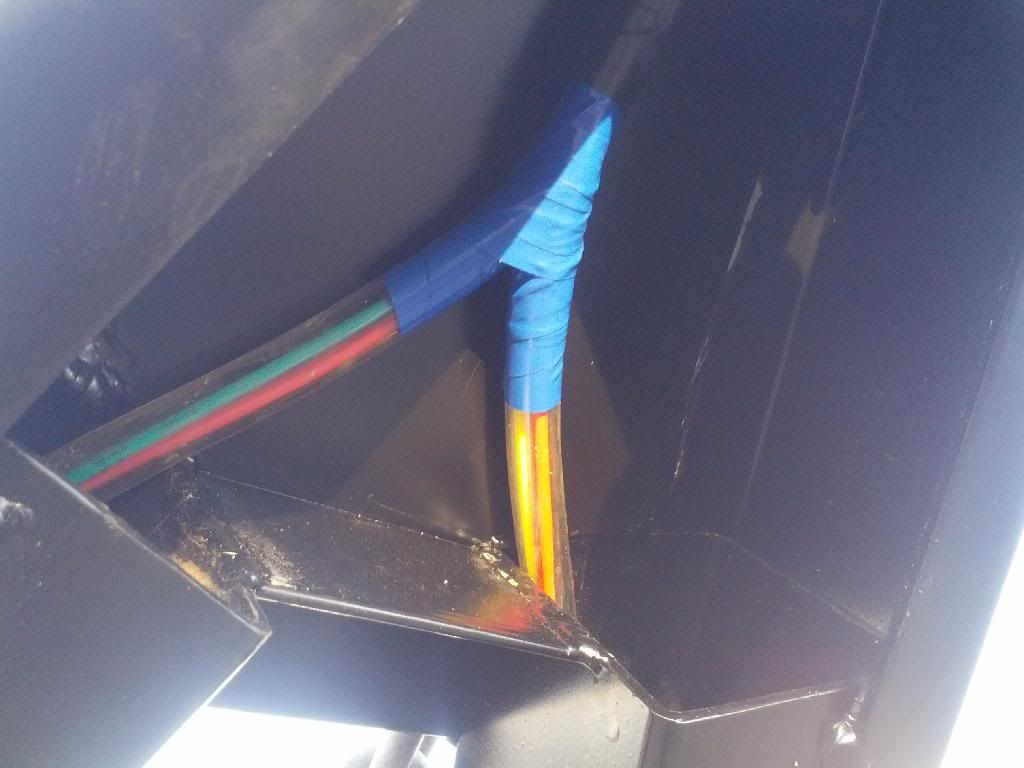

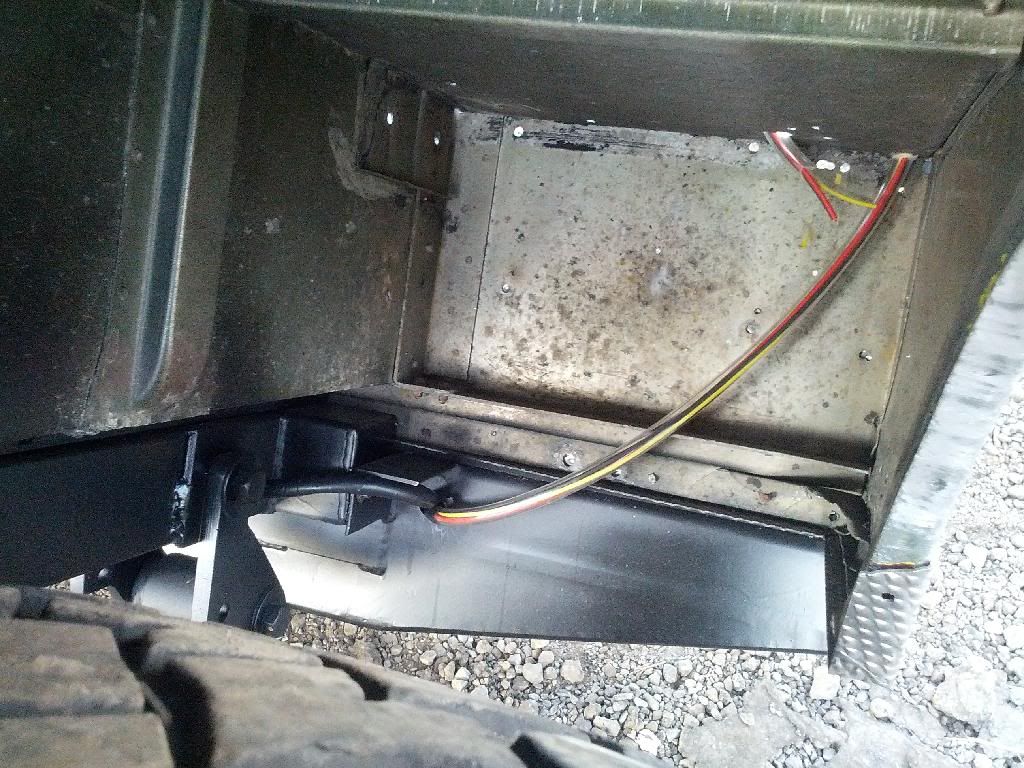

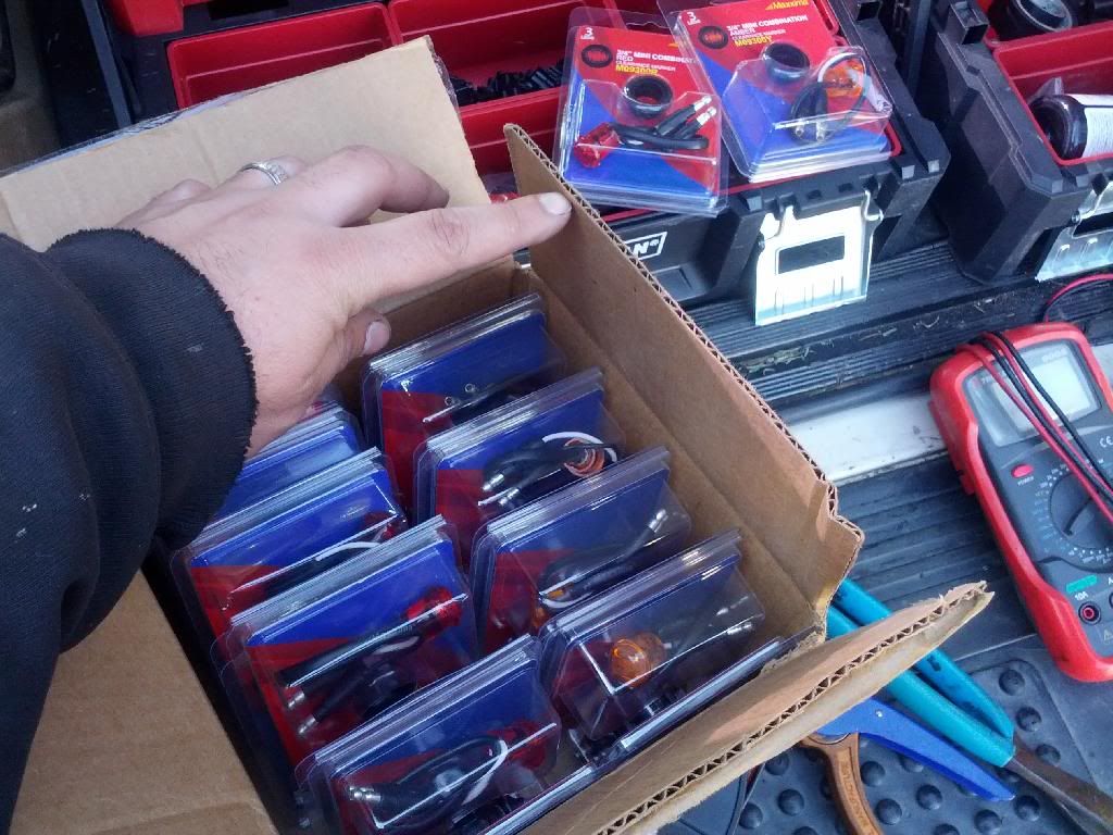

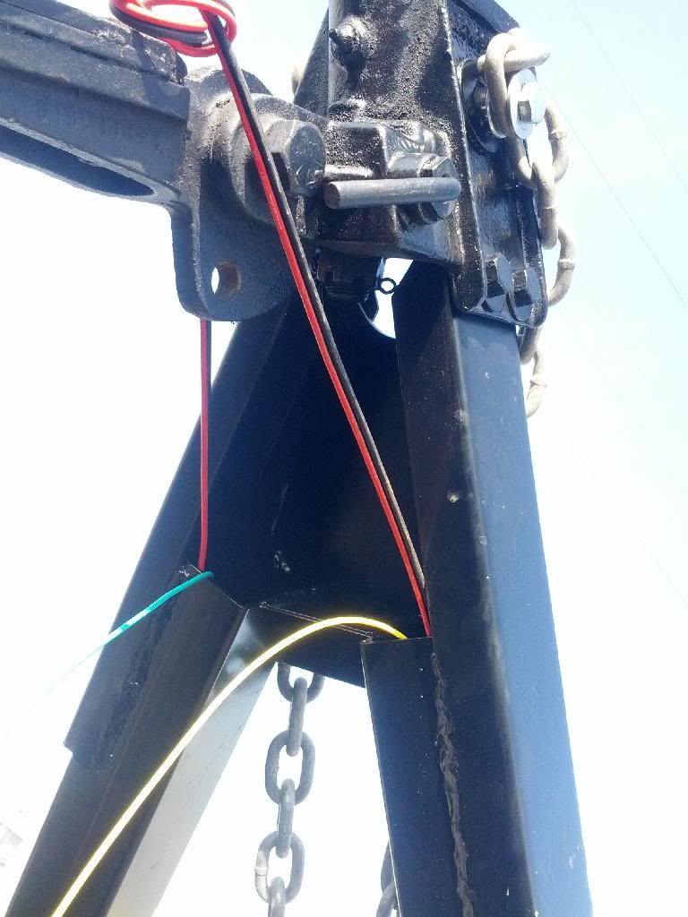

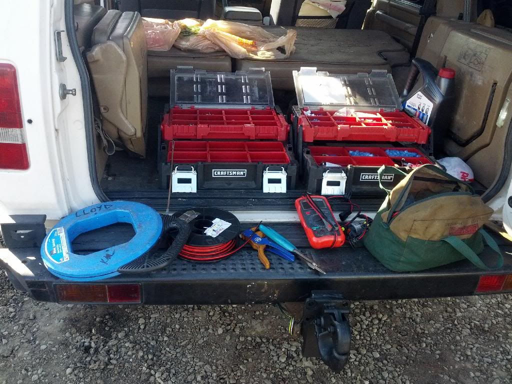

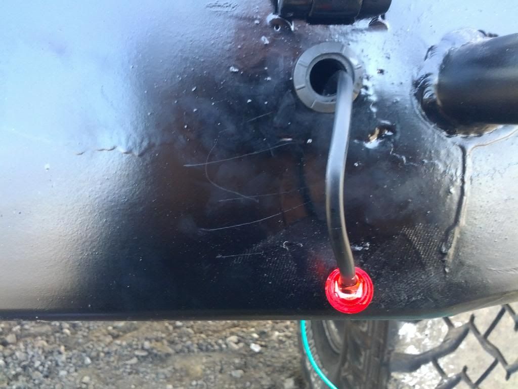

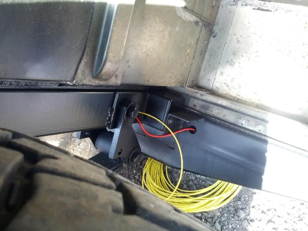

Now I have to remember that I do need another wire for the brake lights. So I ran another color coded wire for each side. Yellow and green. I went to Ebay for a few electrical things and bought what I would typically need in advance. Not that I wanted to buy just for my trailer but for many other electrical things like LED light bars and etc.
So I have a good supply of wires and connectors.
Also I finished my wires and lights for today and need to protect them from shorts on the frame where I drilled. Easy solution. Tubing.

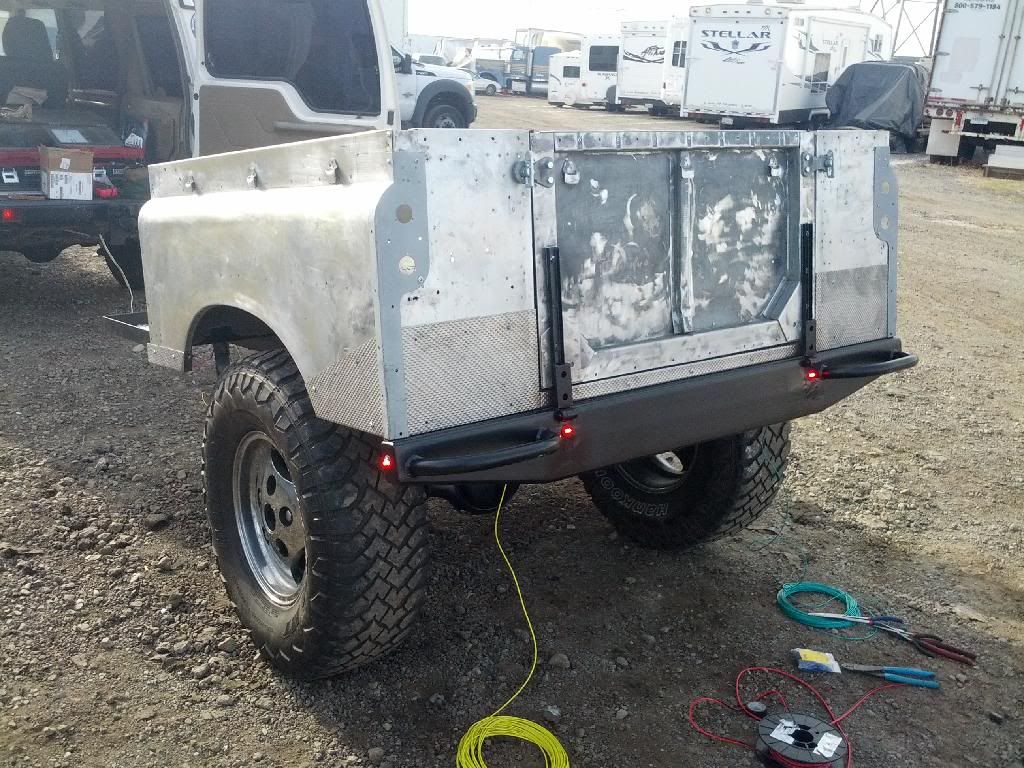

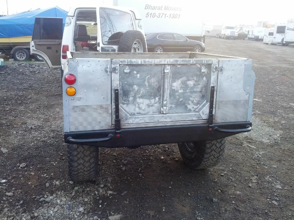

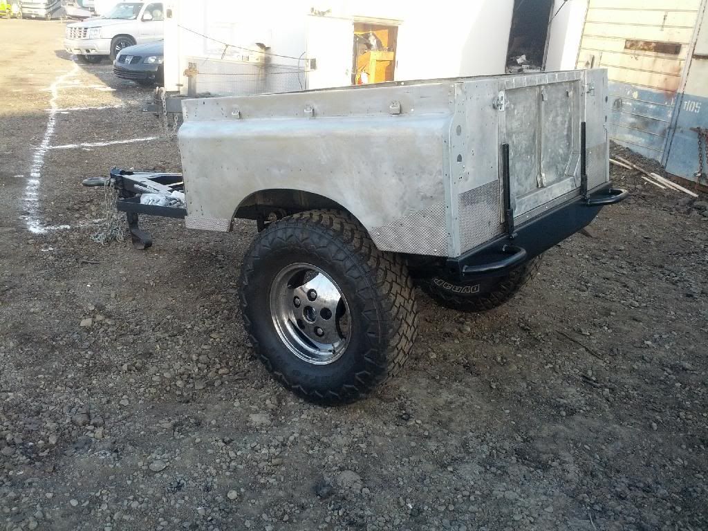

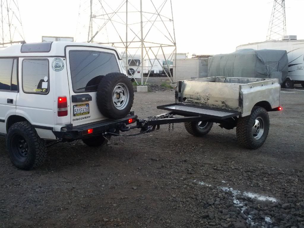

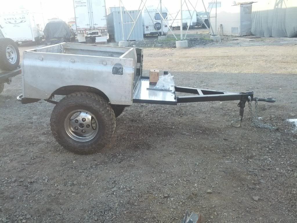

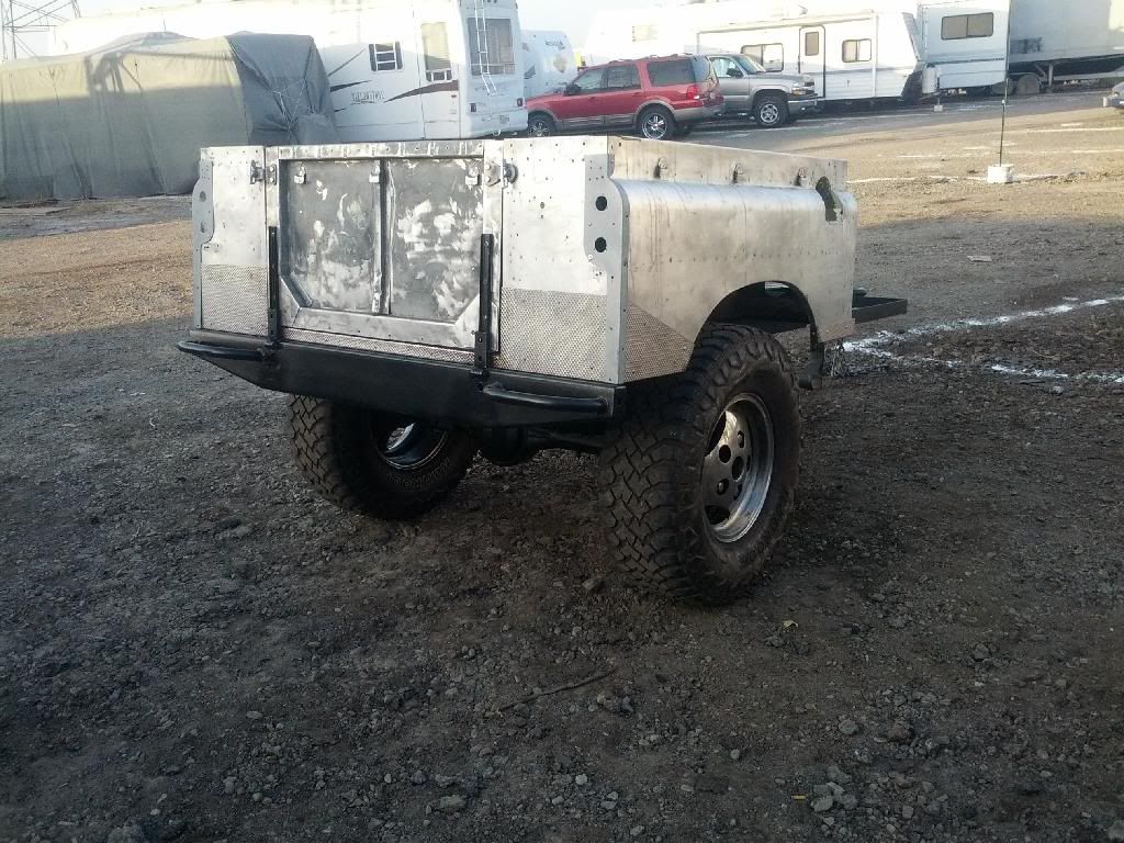

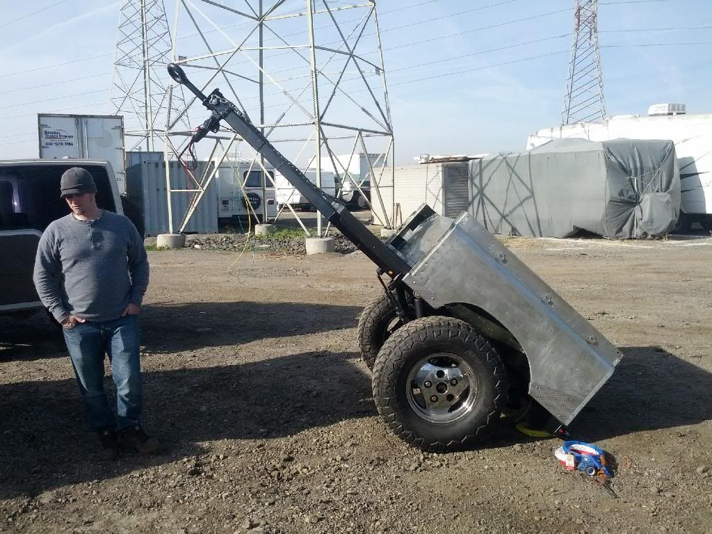

Here is what it looks like done today.
Posted Image
Posted Image
Posted Image
And love the height to my truck with the pintle I made. It can't get any better than this.
Posted Image
Posted Image
Posted Image
Posted Image
Posted Image
Posted Image
Posted Image

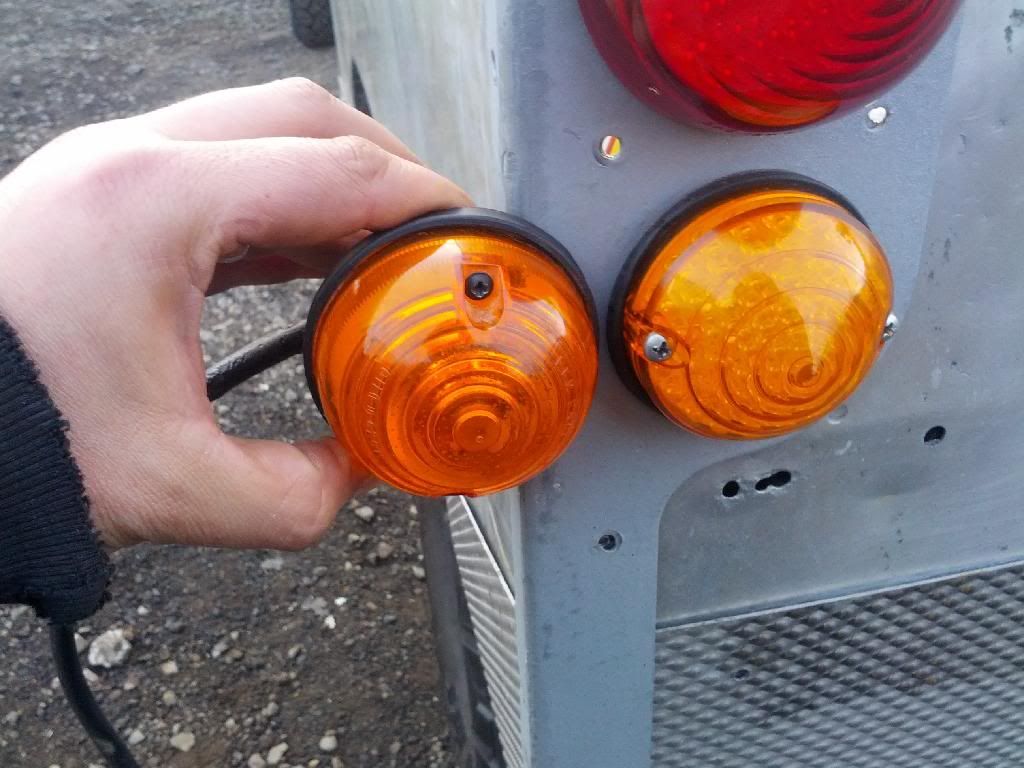

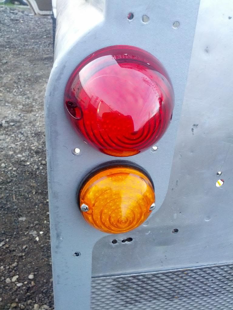

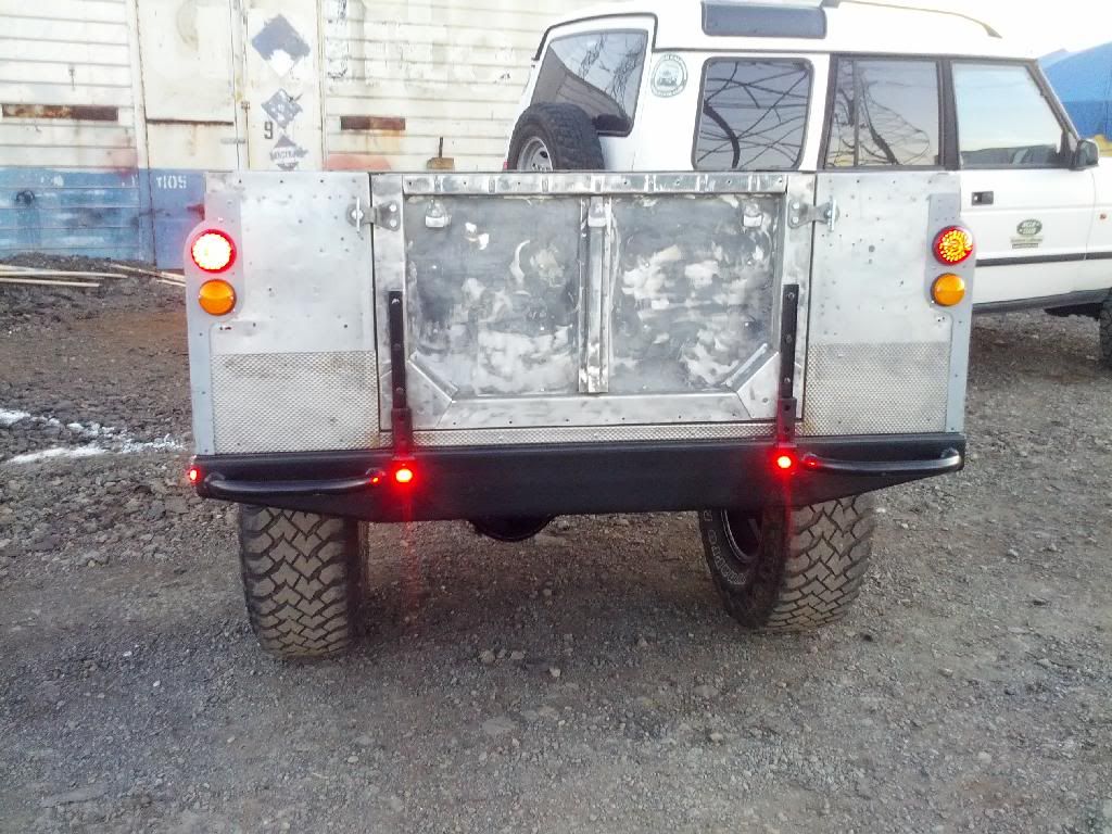

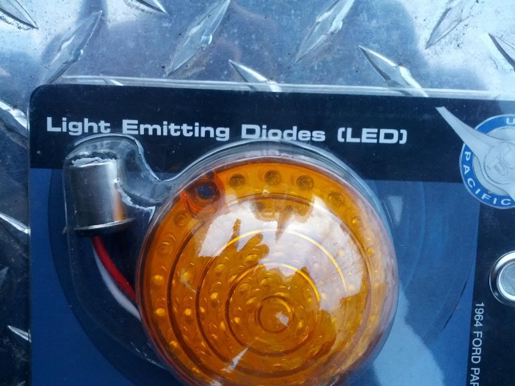

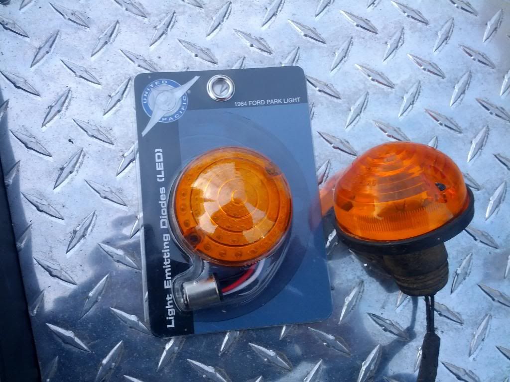

Imagine this.... a 1966 Ford Mustang front bumper signal light is identical to the LR tail lights. So I got my amber light in LED covered. And it was shipped here in two days for half the cost from anywhere. The red light was harder to find but I found the closest I could. A 1955 Chevy taillight. LED too.
Posted Image
Posted Image
Posted Image
Posted Image
Posted Image
Posted Image
Posted Image

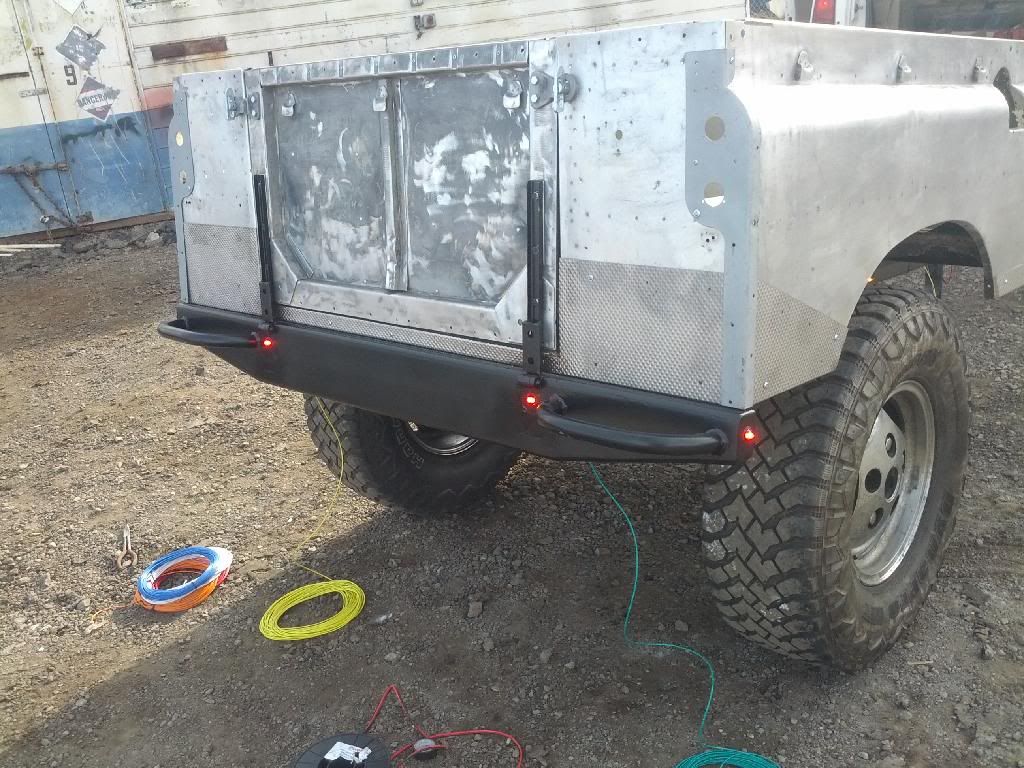

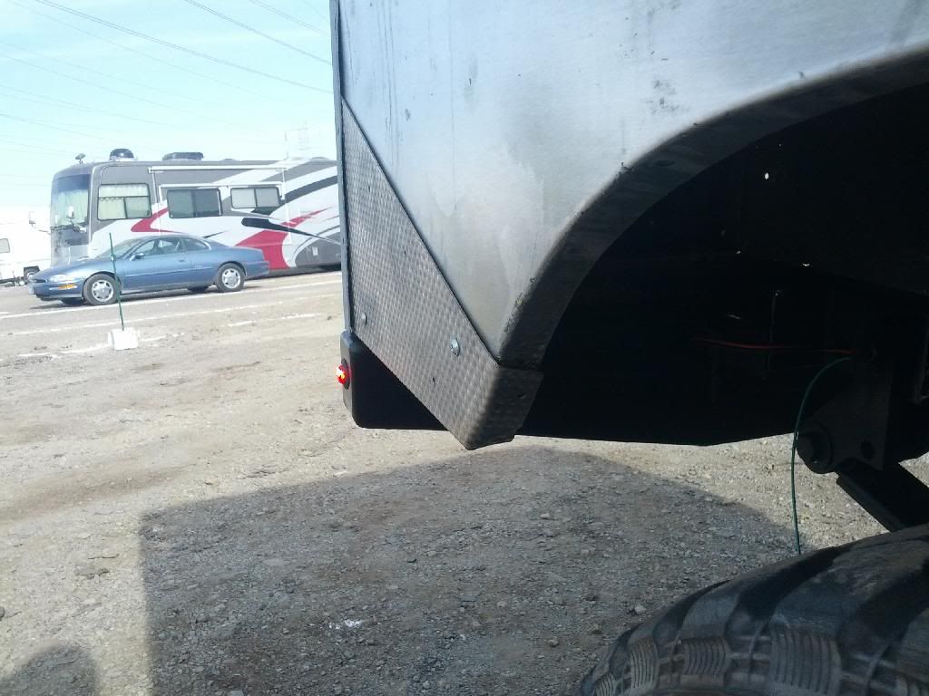

Started wiring the lights and then I was ready for testing my angles. Oh wow. I'm happy.
