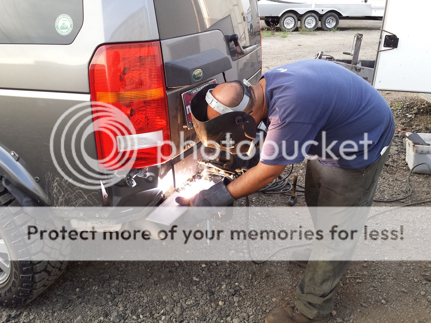

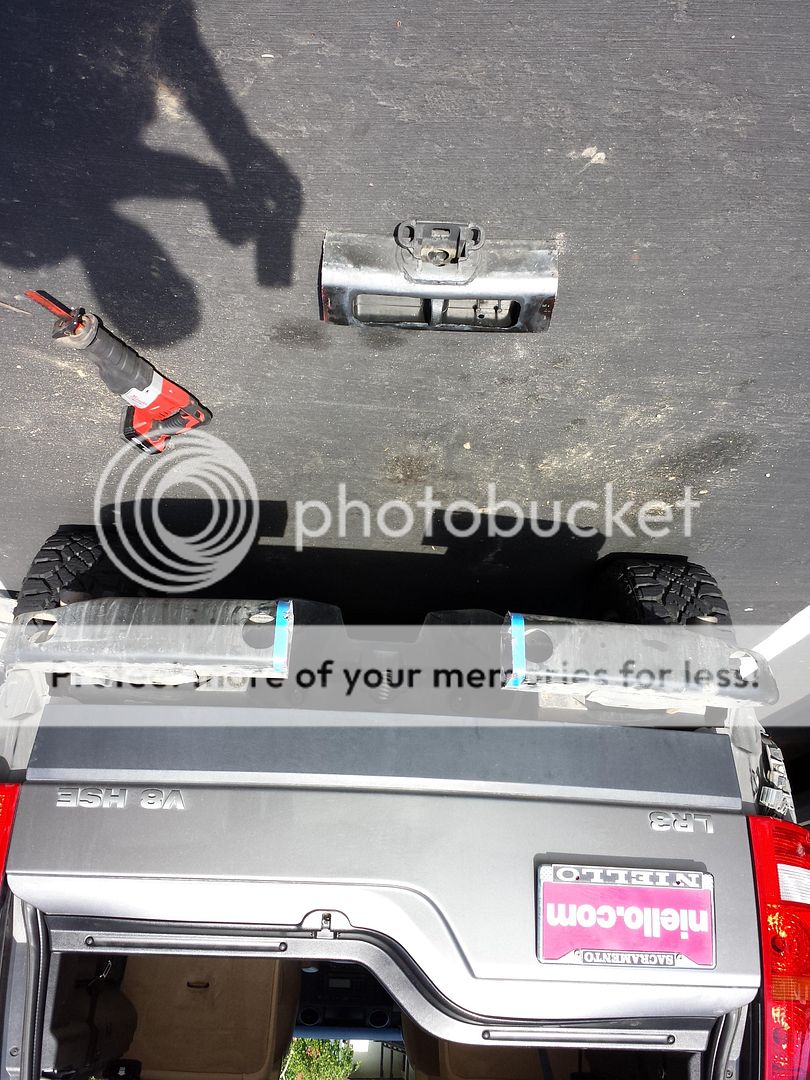

So I happened to stop by Pedram's place this afternoon.
Hmmm....seems like there is some steel under that plastic. And it's welded in place in such a way that that you can't really get to it to just remove the welds. OK, there's a way around that. It's called a sawzall...
Posted Image
Oh boy, no going back now!
Posted Image]
I think we'll end up building off the existing steel piece as it's pretty sturdy. The center recovery point was removed to make way for a regular receiver hitch so I can tow without having to deal with the ridiculous stock Z-shaped thing that hangs waaaay down low. The end bumper should look similar to the Tactical unit but with dual swing outs and the towing capacity.
Hopefully we can have this sorted out in a couple weeks. It's a bit more complicated than Pedram's normal builds but I have faith in him. (I'd better at this point!)

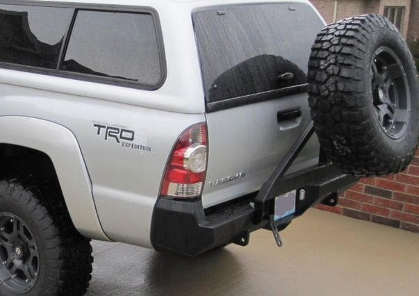

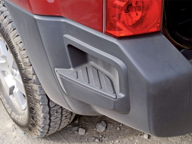

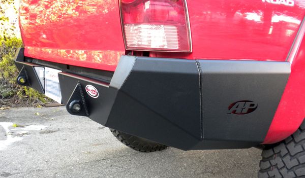

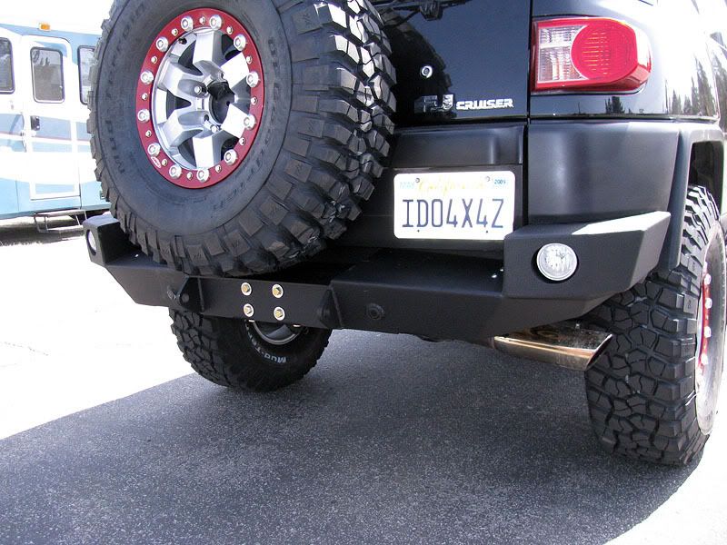

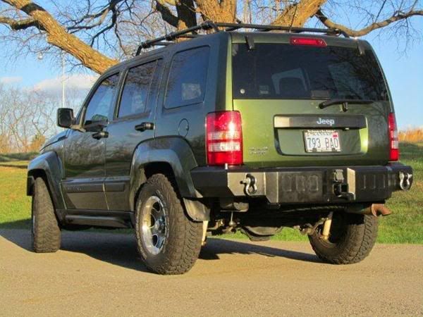

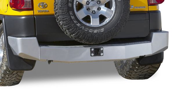

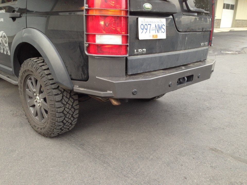

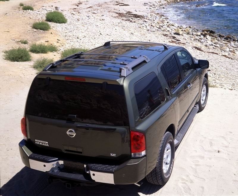

So I started this and haven't really gone further, but I have done a few things. Don I didn't take any pictures of it yet but I was thinking about something else for the two corners. I know you like the TR44 bumpers style but those corners to me look like they need something. Can I box them in? Rather then build a similar wall that matches the original bumper? I'm talking about the curve below the taillight.
My idea is that most SUVs have a boxy rear bumper on this type of body. They usually fallow the rear corners out with a plastic box of some kind. I know you like the Rovers style but just asking. Here are some pictures of what I think might help.
Posted Image
These are some ideas of whats out there and I was thinking of adding a step into it like the Xtera from Nissan. Again just some ideas. But it's your truck. Think about it and let me know what you want to do with it.
Posted Image
Posted Image
Posted Image
Posted Image
Posted Image
Posted Image
Posted Image
Posted Image
Posted Image
But I did take some pictures after you left. I took the truck to my storage and did match the body style under the light with some thin sheet metal and got close. I'll post here as I go since this is my general thread for just building things.

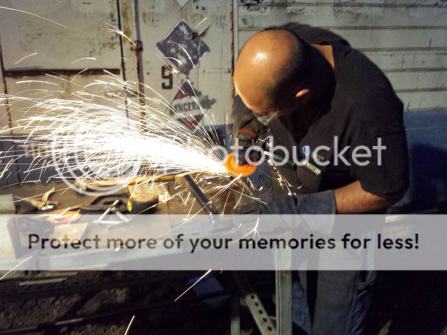

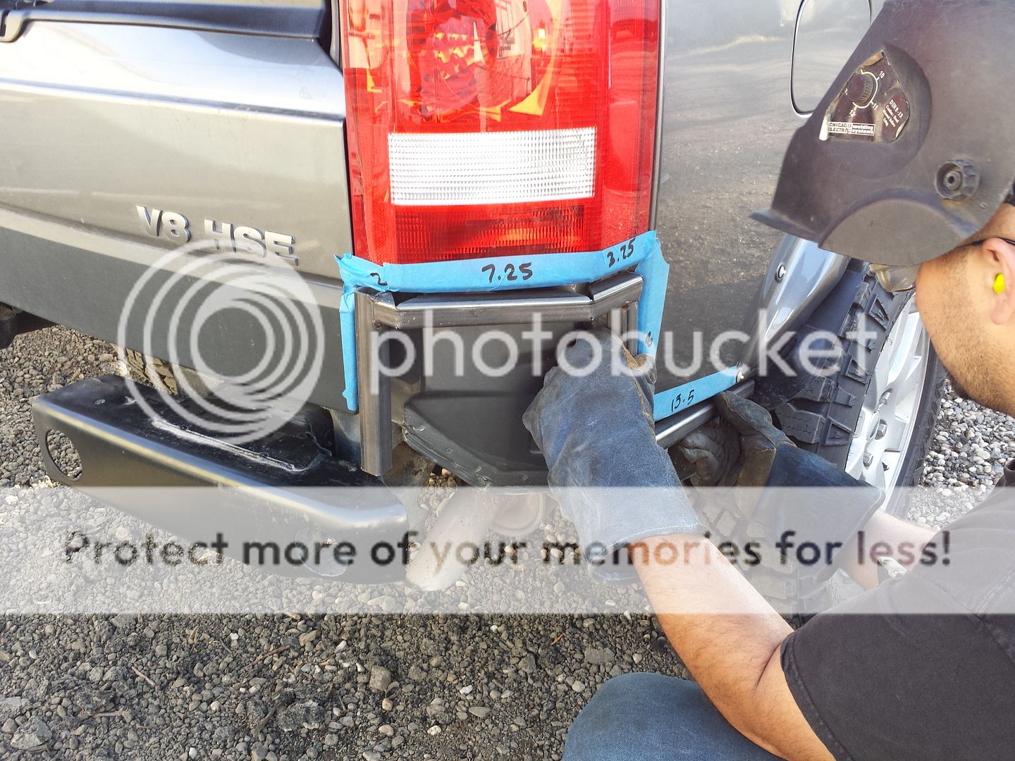

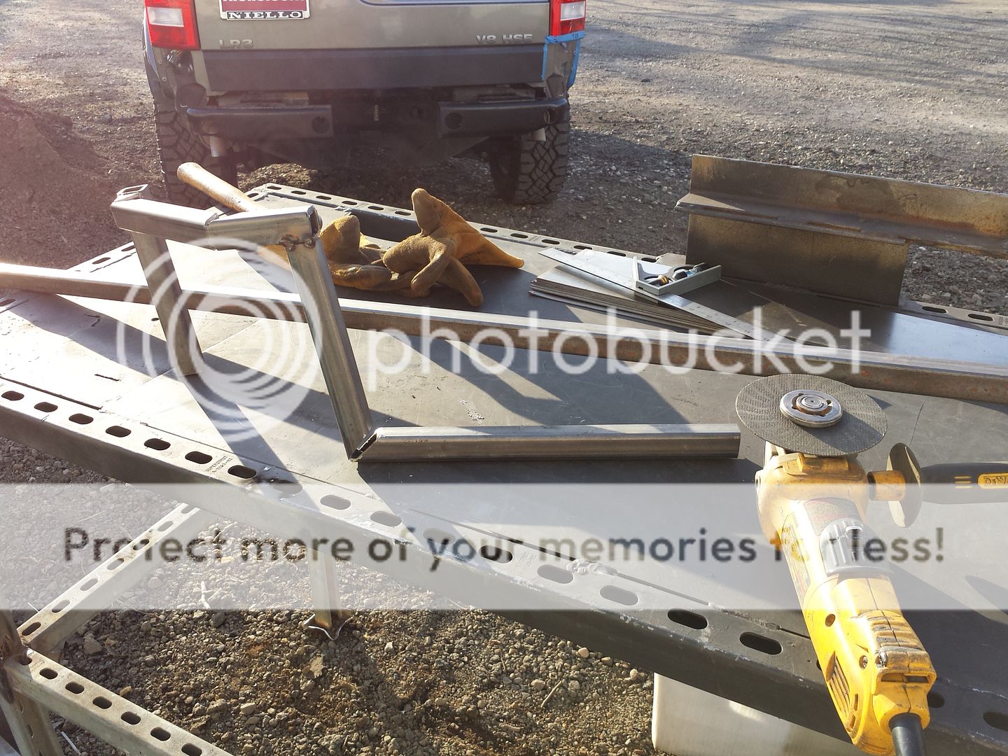

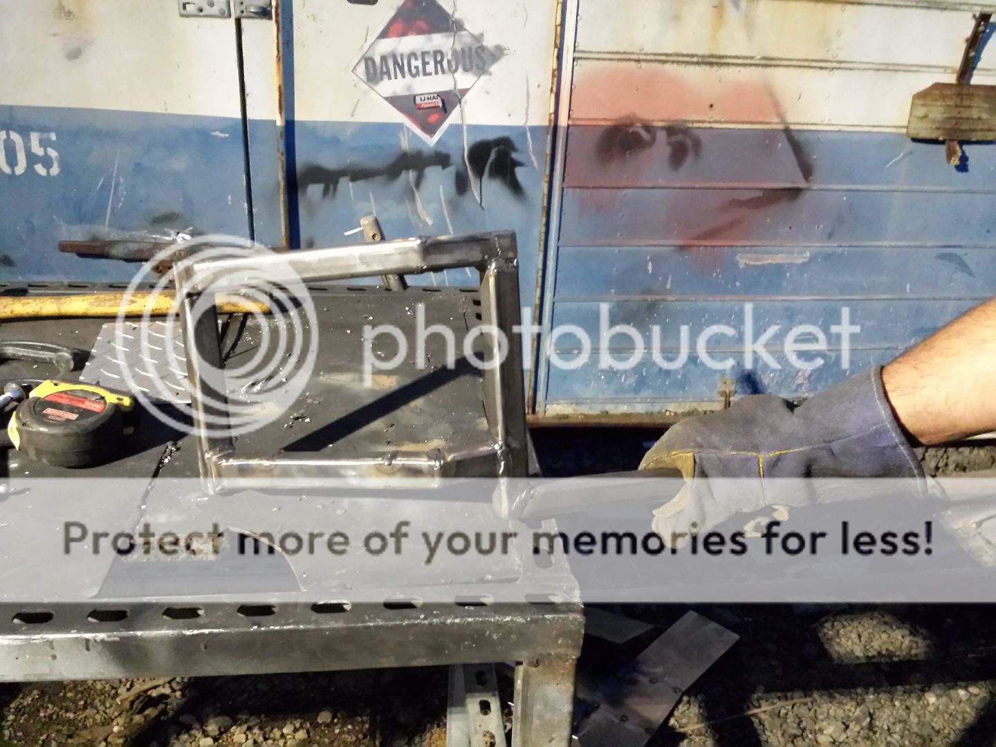

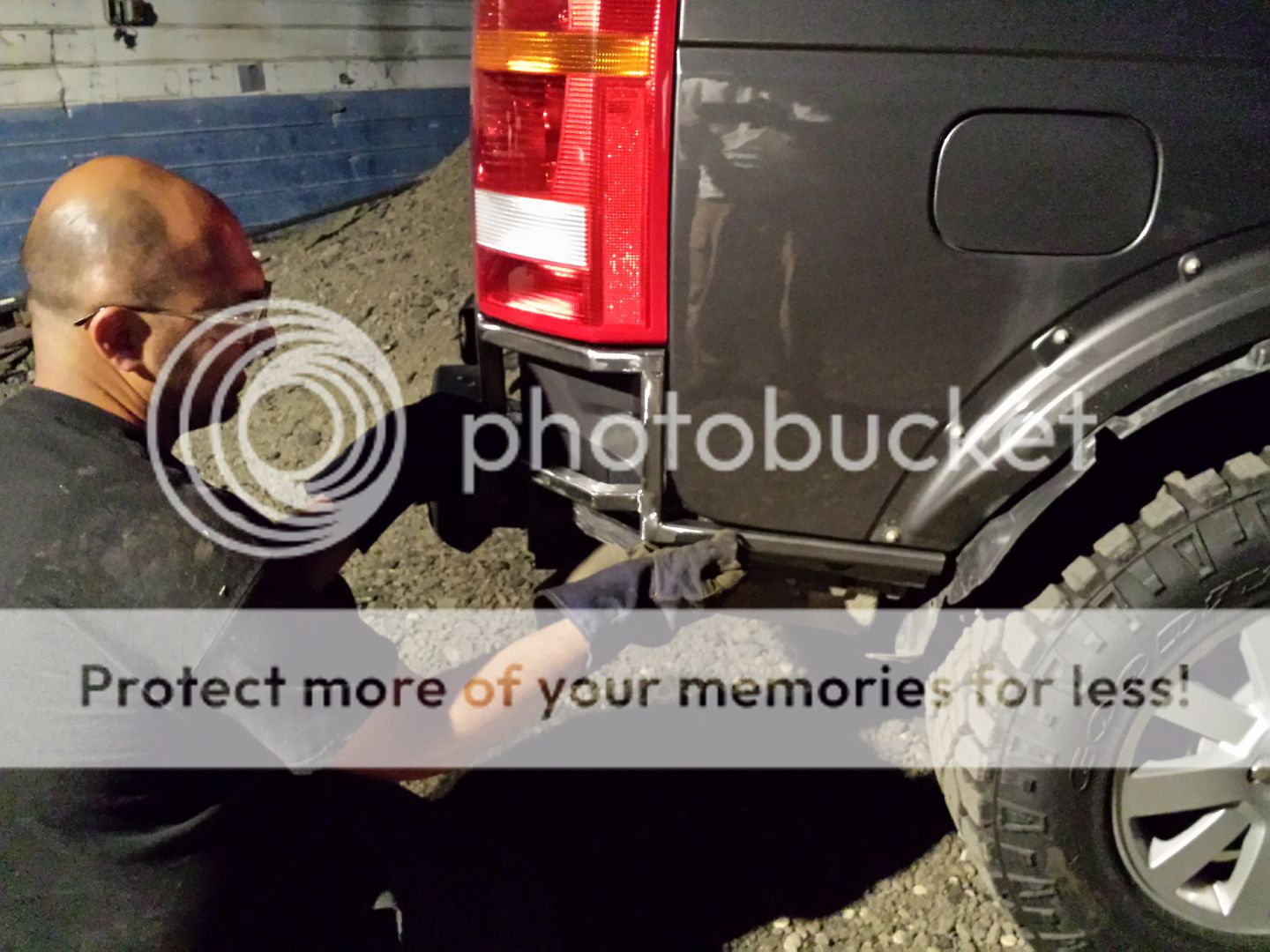

I went over to the secret lair last night. Things happened.
What's this, the start of some kind of shovel?
Posted Image
Oh....that makes more sense.
Posted Image
But that's just a rough draft. It still needs a little of this and that.
Posted Image
Then you end up with something more like this.
(OK, this photo is actually before the grinding but it made for a better story this way)
Posted Image
Hey, now that's looking like the start of something!
Posted Image
These corners will be the hardest parts of the whole build. Hopefully now that we've got a basic design sorted out it go a little quicker on the other side. These are actually a little more complicated than the TR bumper. If you look closely at the top photo in Pedram's post above you can see the TR bumper seems to have 2 planes under the tail light, but the light actually has 3 planes which we followed to keep closer to it's shape. Actually, the main flat part of the light isn't flat at all, but we're not going to try rolling a bend into the steel. (I don't know anybody who does). We're leaving around 1/4" of gap under the light to avoid damage from an impact. I'll likely fill this with a rubber gasket of some sort just for cosmetics.
What I learned last night: The LR3 has something in common with the boats I'm on all day. Despite looking much like a square brick, there doesn't appear to be any actual 90* angles on the back of this truck.

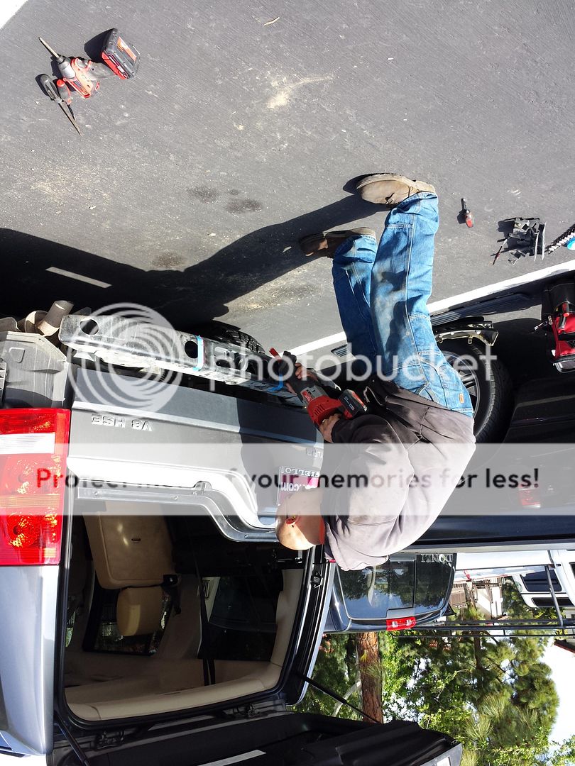

More progress was made last night. By the end of the evening it was actually starting to look like a bumper. Unfortunately, I forgot to take a pic at the end. There's still plenty to do though, a few days' worth of work. Here's a quick shot of Pedram attacking the LR3 with the welder. We'll have to let him post some pics of the over-all progress.
Posted Image
