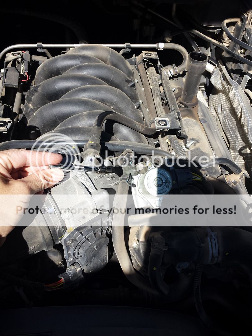

After seeing two of what are basically the same thing fail on two different Rovers over the course of one trip, I though I should check mine. Sure enough, I've still got the OEM plastic one. Although it looks fine, I'll replace it with brass.
Thanks for the head's up Ted.
Here's a photo of the offending part (I'm pointing at it with the extension). Notice the cap is brass, while the body is plastic - brilliant!
Posted Image
Is the cap just a cover on a threaded end or is there a real valve of some kind in there? I'm thinking of something like the Schrader valve on the fuel rail ... or is it just a capped "T"?

I want to say it's just a cap, but now I can't picture it.
I was surprised not to spill more than a few drops when I removed it. I then topped off the coolant which was actually slightly low (less than a quart) and let it heat up to open the thermostat and cracked the plug on my home-made partially open to purge it. I'm heading out this weekend so hopefully it will do the trick under load.

I want to say it's just a cap, but now I can't picture it....
Don,
My guess is the cap has a rubber seal on the inside top of the cap and the thread has a groove down it. By unscrewing slightly you create a small passage for air to bleed out. Rather like the top hose bleeder on a D2. Just trying to educate myself ....

I had to go home tonight to take care of some things so I snapped a pic of the stock T. It's pretty much just a cap; no groove down the threads, no O-ring, nothing special.
Posted Image
