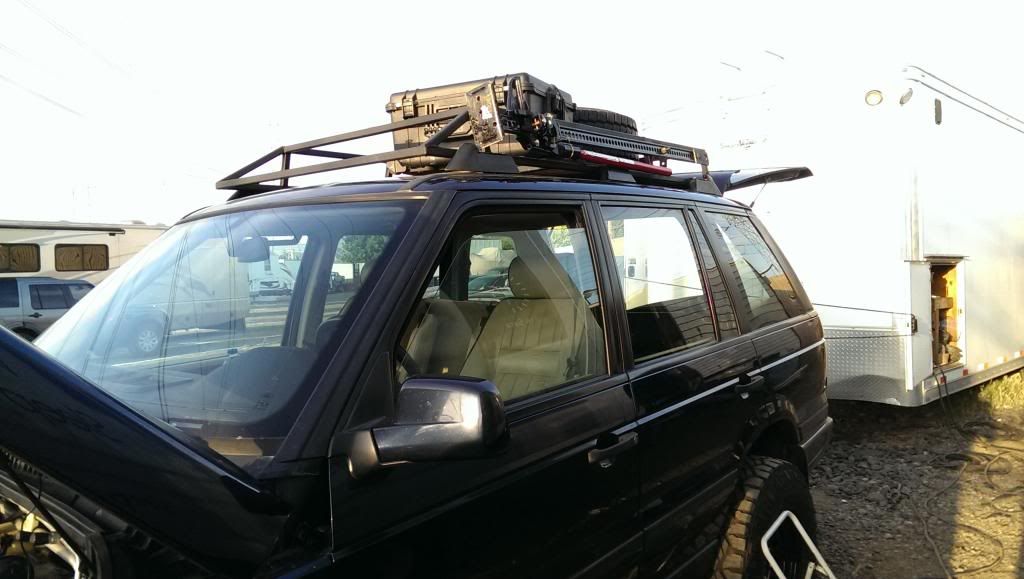

I joined the club. I just drove my 1999 Bosch p38 home today. I couldn't be happier. It ran well no issues at 70-80mph for about 70 miles.
It has 184k miles and was purchased as a lien from a shop that installed the coil suspension. I believe someone has done work to this due to a Land Rover tag install the engine bay dated from 2001.
It handled well and couldn't be happier. I'll update later with differences between 80'and 100 series LC.
